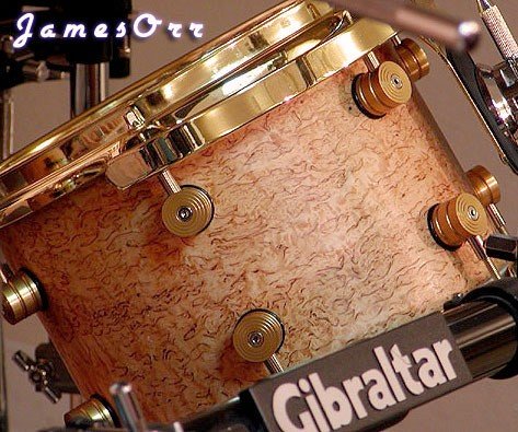

Having built a few drums, I can tell you guys that the truth is in the
middle as far as drums go. I built a snare out of 1/2" zebrawood. Super
loud, but very very fast decay. Kits like the one in the pic were about 1/4"
thick. The thinner shell isn't as loud but the drum resonates much
longer. Shells a ply thicker don't resonate as much, and shells that are
even thinner don't have much of anything going well for them.
I wish I could do double sides. No bending, and a stiff rim. I don't have
the ability to thickness though.

James, very cool about the drum shells... I didn't know you made those. It looks fantastic
